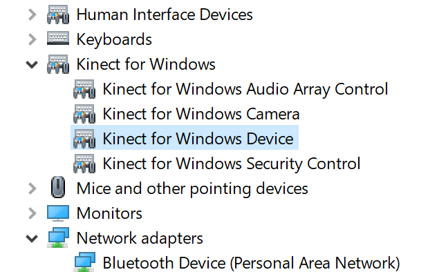

The new Kinect driver must also be installed manually. To install the new driver follow the steps below:
  1. In Cortana type ‘Device Manager’ and hit enter
  2. Find ‘Kinect sensor devices’ in the list
  3. Expand everything under ‘Kinect sensor devices’ (this should expose ‘WDF KinectSensor Interface 0’)
  4. Right click on ‘WDF KinectSensor Interface 0’ and select ‘Update driver’
  5. There should be a popup window that asks “How do you want to search for drivers?”
    1. Choose “Search automatically for updated driver software”
  6. Assuming all goes well, you should have just installed the new driver. Right clicking on ‘WDF KinectSensor Interface 0’ again and selecting ‘Properties’ should show you that you have driver version ‘2.2.1610.17001’ or greater
  7. If all does not go well and you did not get the new updated driver with the version listed above, remember that the driver takes time to filter through our backend system and be visible to all locations around the globe. If this happens, please be patient and try the same steps listed above at a later time.
For any issues regarding installing the new Kinect driver please let us know by commenting below.

    It sounds like you might have the old Kinect driver installed. I would suggest unplugging your Kinect, uninstalling the Kinect SDK along with your current the Kinect driver. Then reboot, plug in the Kinect again and wait for the latest driver to install. After all of this check back to the original post of this thread to make sure your Kinect Driver version matches what is on your computer.
    Let me know if that works.
    I had 2.2 driver intalled by default when in installed new windows. Unfortunaltellly, today after installing SDK it is stuck on 2.0 (2014) Driver i tried updating it using every possible way but it shows [Encountered a problem while installing driver software for this device]
    Before i was using it as camera too but now in camera also showing error. How can i update that?

    2018-03-12T16:16:49+00:00
    i have tryed everything but nothig works. i have a Surface from the second Generation an a have sucessfull scanned some objects last year. But in the meantime my pc installed the newer version of the 3D Scan APP. Now nothing work. I already update the driver an if i run the Kinect Configuration Viewer, i can see the stream wit 30 fps. I only get a warning undefined USB bandwidth.
    The test with the camera app also not work. I can oly see the two build in cameras.
    i hope someone can help me.
    BR
    Bernhard
