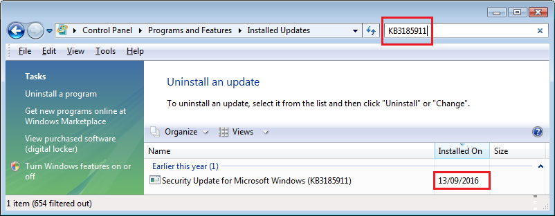

    Before you go any further, please confirm that you followed STEP # 3 of the instructions in m#l's thread Updates not working, it has been searching for updates for hours and searched your installed updates (Control Panel | Programs | Programs and Features | View Installed Updates) for the exact string KB3185911 (and not a partial string like 3185911) as shown below.  You might need to wait a few minutes for all your 500 to 600+ installed updates to populate the window before you can start the search.

    I've checked my installed updates and I definitely don't have kb3185911. That patch was issued in September, 2016, but my last successful update was on the 8th May 2016 (which was just Office updates), and my last Windows update was on 10th March. I've also checked my user32.dll. KB3185911 should install version 6.3.9600.18439, dated 14th August, 2016. I have version 6.0.6002.19535, dated 6th November, 2015.

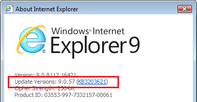

    As one last experiment, open your IE9 browser, go to Tools | About Internet Explorer, and check if you have the latest Update Version 9.0.57 (KB3203613).  If you have an older version, save the latest 32-bit Vista SP2 .msu installer for KB3203613 (MS16-144: Security Update for Internet Explorer: December 13, 2016) from http://www.catalog.update.microsoft.com/Search.aspx?q=KB3203621 vista to your desktop and run it as previously instructed.
    If you get another "not applicable" warning, just an FYI that there is an alternate way to search for KB3203613 if you can't find it when you search your installed updates at Control Panel | Programs | Programs and Features | View Installed Updates.  You can open an elevated command prompt (click on the Windows Start button, enter cmd in the search box, right-click on cmd.exe, and select Run as Administrator) and enter the command wmic qfe | find "KB3203621" (with quotes around the KB number) as instructed in the article Get Hotfix Information Quickly with WMIC.
