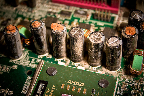

    Everything looks pristine inside. No bulging caps, nothing. The way I get the BSODs (on start up, when the PC hasn't been used for a while) perhaps suggests a hardware fault, but I can't see anything obviously wrong. I think, as GWN suggests, the way forward now is to work on the next BSOD, if and when it happens. And then get a new PC, obviously.

    as to the boot time start up BSOD
    look on the Motherboard for blown caps
    if there are blown caps then it's a lost cause
