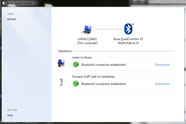

Im having issues with my Bose QC35, i have successfully installed (or at least i think i did it). But i cant play any sound on them, is like they are not paired at all. After a few minutes the QC35 gets off saying there is no device available.
Just to add, the QC35 are working perfectly fine with my android phone and also other laptop with Windows 10
Bluetooth Devices:
Bose QC35 Properties:
If i go to the operation windows (right click on the BT device icon)
When i go to sound devices i cant see the QC35. (same if i try from Skype, Spotify, etc)
I have already downloaded the latest driver for the bluetooth from Dell, restarted the laptop hundred of times and also contacted Bose without luck
If anybody can shed some light on this i will very gratefull

    Hi Jemille, see below my comments.
    Have you tried connecting another headphone on your PC to make sure that the port is working properly?
    what port are you referring to? I have tried with the Motorola buds which are also Bluetooth and they work just fine, also i have my mouse using Bluetooth without issues.
    Do you get any error message when using your headset?
    No, in fact im not able to use it. Windows is recognizing the headphones but not displaying it as a sound deveice
    Run the fix it for hardware devices and check if you will still encounter the same issue.
    I did it, no hardware issues found.
    Perform clean boot to start Windows by using a minimal set of drivers and startup programs. This helps eliminate software conflicts that occur when you install/run a program on your OS. Refer to this link to perform the clean boot in your Windows 7.
    Same result, im able to see the bluetooth device on the control devices but not able to reproduce any sound. And if i check the connection from the headphones is like is not connected to the laptop.

    Hi jamille,
    the QC35 is not there. I have updated the bluetooth drivers also.
