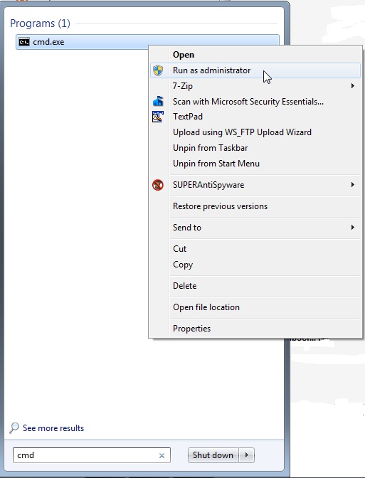

    Click the Start orb/button and in the box enter the following:
    cmd.exe
    Right click cmd.exe and choose to Run as Administrator:

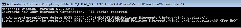

    The command to enter is:
    reg  delete  HKEY_LOCAL_MACHINE\SOFTWARE\Policies\Microsoft\Windows\WindowsUpdate\AU
    It is "safe" even if the policy does not exist in the registry and you have not used regedit.exe to do it so there is no chance of making a mistake in regedit.exe.
    You will see:

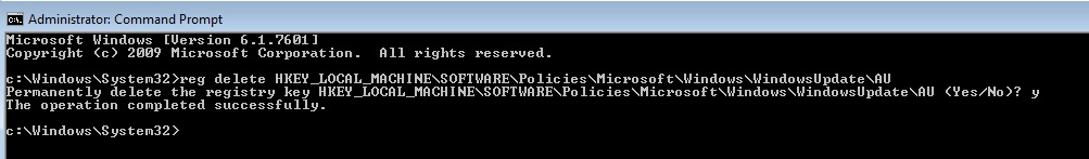

    If you respond in the affirmative the key is removed and the problem is resolved:
    So you removed the key and fixed the problem without using regedit.

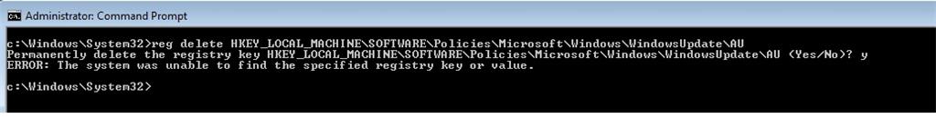

    If the key is not present there is no harm in executing the command:

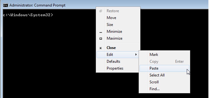

    You can also copy the command to the Windows clipboard (select all the text of the command, press Ctrl-C to copy).
    Now that the command is on the Windows clipboard right click the title bar of the Command Prompt window, choose Edit, then paste the contents of the clipboard into the Command Prompt window:

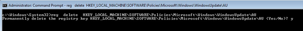

    Now it should look like this:
    Press Enter and respond in the affirmative:
