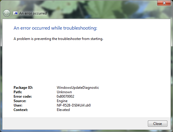

    3 years old. All of it. Yes, it's a valid key, and I may have the disks around here somewhere.

    I'm aware that there are several fine security software suites available. As of this writing, I've run AVG and Malewarebytes. Neither scan found a single problem with the computer.
    These computers do not browse the internet. They only serve to operate lab equipment. They have Teamviewer installed for remote operation but other than that they are not used online. Additionally, we're behind a vast and powerful firewall maintained by my institution's IT department.
