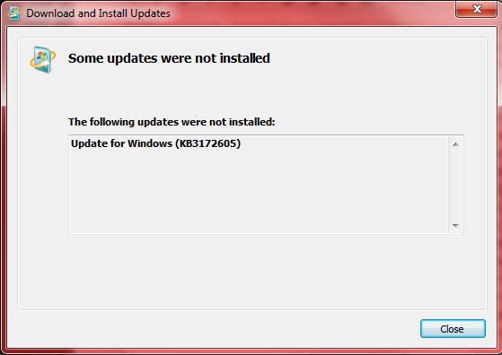

Windows Update Doesn't Work even with the SOLUTION
2016-10-23T00:11:52+00:00
FIRST. If Windows Update is not working or taking far too long (more than 15 to 30 minutes) try the Solution described in the thread at

If after trying this the problem persists, then follow these directions to first reset Windows Update.
This is a bit technical, but if you can follow it, I think it will work for you.  I work on a lot of computers and this works for me.
I emphasize that for this to work, you must follow exactlyas this describes.

You are now going to download and install either one or two updates manually.  In most cases only the first (KB3172605) of these is needed.  If that produces a result that says the update is not appropriate for you computer, you need to first install the 2nd of these (KB3020369), then install the first (KB3172605).  Choose the one that is for your machine — 32 bit (X86) or 64 bit (X64).

After restarting your computer, wait about 10 minutes until Windows Update completes its tasks.  Do not use the computer for any other purpose during this wait period.
Start Windows Update.  It will take only a few minutes to come up with a list and download the updates you select.  The process is quite normal as it always was from this point onward.
If your computer has not been updated for a long time, it may take longer.
