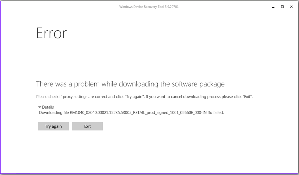

I have been fidgeting with Windows Device Recovery Tool (WDRT) since the day I started installing Insider builds on my phone. It's a very useful software and saved a lot of phones but unfortunately for the last few days it was giving me trouble. Every time I tried using it, the package download would stop midway and throw an error "Please check if proxy settings are correct and click 'Try again'." This made me search the forums, try all given solutions and whatnot but nothing helped. Only today did I solve it and now it is all fine. While searching through the forums, I found that none of the solutions helped anybody and so I am going to post the solution in case anyone faces the same problem and gets stuck.

    Click 'try again' for a few times and the download should resume. If that doesn't help, check my main post again, I have updated it with a fix for the 'proxy' problem.

    Hey Bro
                     i have tried everything you mentioned above (i.e)
     tried by added the WDRT to firewall extension and also tried by turned off the firewall settings and in some other systems also tried to download but still i'm facing the same problem that please check the proxy settings and try again.
    But i didnt tried your update2 because that link you mentioned was under maintenance so do you have any other solutions for this. help me to solve this bro !!!!!!
