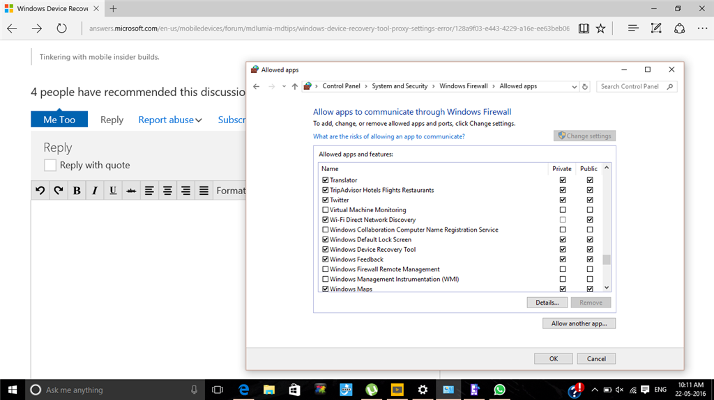

I have been fidgeting with Windows Device Recovery Tool (WDRT) since the day I started installing Insider builds on my phone. It's a very useful software and saved a lot of phones but unfortunately for the last few days it was giving me trouble. Every time I tried using it, the package download would stop midway and throw an error "Please check if proxy settings are correct and click 'Try again'." This made me search the forums, try all given solutions and whatnot but nothing helped. Only today did I solve it and now it is all fine. While searching through the forums, I found that none of the solutions helped anybody and so I am going to post the solution in case anyone faces the same problem and gets stuck.
  1. Open Control Panel.
  2. Click on Windows Firewall option( if you use another firewall, you'll find these settings in its UI)
  3. Click on "Allow an app or feature through Windows Firewall"
  4. Click on "Allow another app"
  5. Browse on your PC for the WDRT file and add it
  6. Try downloading the files for your phone again, it should work now.
