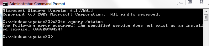

    just rebooted.
    administrative command prompt w32tm /query /status displayed:  The following error occurred:  The specified service does not exist as an installed service. (0x80070424)

    after reboot and after the above error I looked again at the control panel -----> services----> windows time is missing again.
    ![](http://fud.community.services.support.microsoft.com/Fud/FileDownloadHandler.ashx?fid=fdbf2373-766f-4291-b150-aa1362acb15c)
    With windows time missing I ran this Microsoft fixit again:  https://technet.microsoft.com/en-us/library/cc738995(v=ws.10).aspx
    after running the fixit windows time reappeared under services:
    ![](http://fud.community.services.support.microsoft.com/Fud/FileDownloadHandler.ashx?fid=1e3e7c6b-a34c-47b4-8223-2225d069484d)
    How come the windows time is disappearing from the services menu?
    This is the administrative prompt command after the fixit:
    ![](http://fud.community.services.support.microsoft.com/Fud/FileDownloadHandler.ashx?fid=715215ae-d16d-4b61-9363-44e24285c9b6)
    Will reboot now and see if windows time disappears from services
