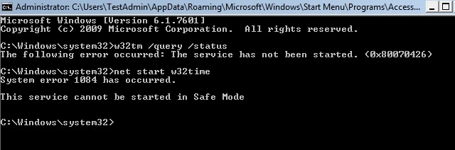

    2016-02-23T16:57:22+00:00
    The time service is not available in safe mode but you should not have received that output from the command, this is what you should have seen:
    I need to know the chain of events leading to your safe mode error, did you:
    1. Do a clean boot.
    2. While in clean boot reset the time service with the /unregister /register commands.
    3. Test the time service and see that it was working correctly.
    4. After being satisfied that the time service appeared to run properly reboot to safe mode immediately?  Or did you do a normal boot first  then boot to safe mode?
    Confirm if the chronology of events and whether or not the service was reset in clean boot.
    John
