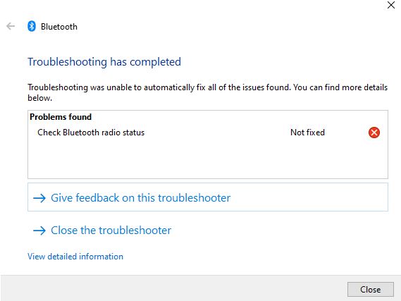

    2020-09-05T23:38:21+00:00
    Details:
    OS Version : Windows 10 Home
    Bluetooth Driver : Qualcomm Atheros AR3012 Bluetooth 4.0
    I have been having problems connecting Bluetooth devices to my laptop presumably after Windows 10 upgrade. I didn't use Bluetooth in ages after upgrade and only saw this problem when I tried to connect a device a few days ago. I have performed all the steps i.e. uninstalling/reinstalling drivers, system restarts, updating the drivers but nothing seems to have worked so far.
    I then tried troubleshooting Bluetooth and troubleshooter shows the following (attached is the image for it):
    "Check Bluetooth radio status" : "Not fixed" <error_icon>
    I then opened "services.msc" and saw 3 bluetooth services:
    1. Bluetooth Audio Gateway Service
    2. Bluetooth Support Service
    3. Bluetooth User Support Service_5679c
    I tried restarting these services and setting startup type to automatic. While it worked for 1 and 2, for 3, I got an error saying parameter not supported. Also, when I tried restarting "Bluetooth User Support Service_5679c", it stopped automatically after a few seconds so it looks like it's failing to start.
    To summarise, there are a couple of problems:
    1. Bluetooth service is not able to start up
    2. Troubleshooter is not able to access Bluetooth radio service
    Has anyone seen these problems before? Could anyone please advice what to do in this case?
    2020-09-04T11:28:46+00:00
    Screenshot has been taken when bluetooth was working correctly. My problem is If I don't turn off the bluetooth from action centre or settings before shutdown. Then only, after next boot, bluetooth will not work and respond. Also, troubleshooter will keep telling resolving problems for hours and say that "turning on bluetooth". And, when bluetooth works correctly then, always troubleshooter shows that "Check Bluetooth Radio Status - fixed".
