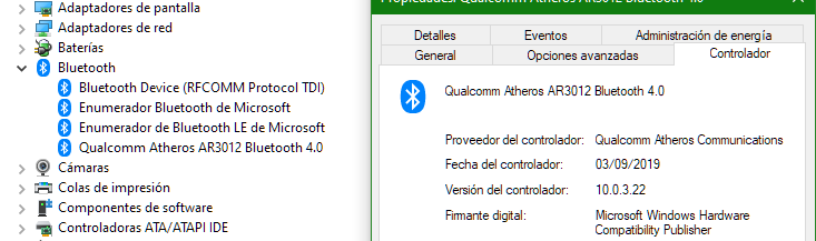

    My issue is that Bluetooth appears in the control panel (as I can seemingly turn it on and off) but Windows simply doesn't recognize Bluetooth devices... I can't pair my phone, Nintendo Joy-Cons, etc
    I had the 10.0.2.11 driver and Windows Update didn't detect a newer driver. Updated to 10.0.3.22 and I experience the same issue :C
    This is how it appears on the Device Manager:
