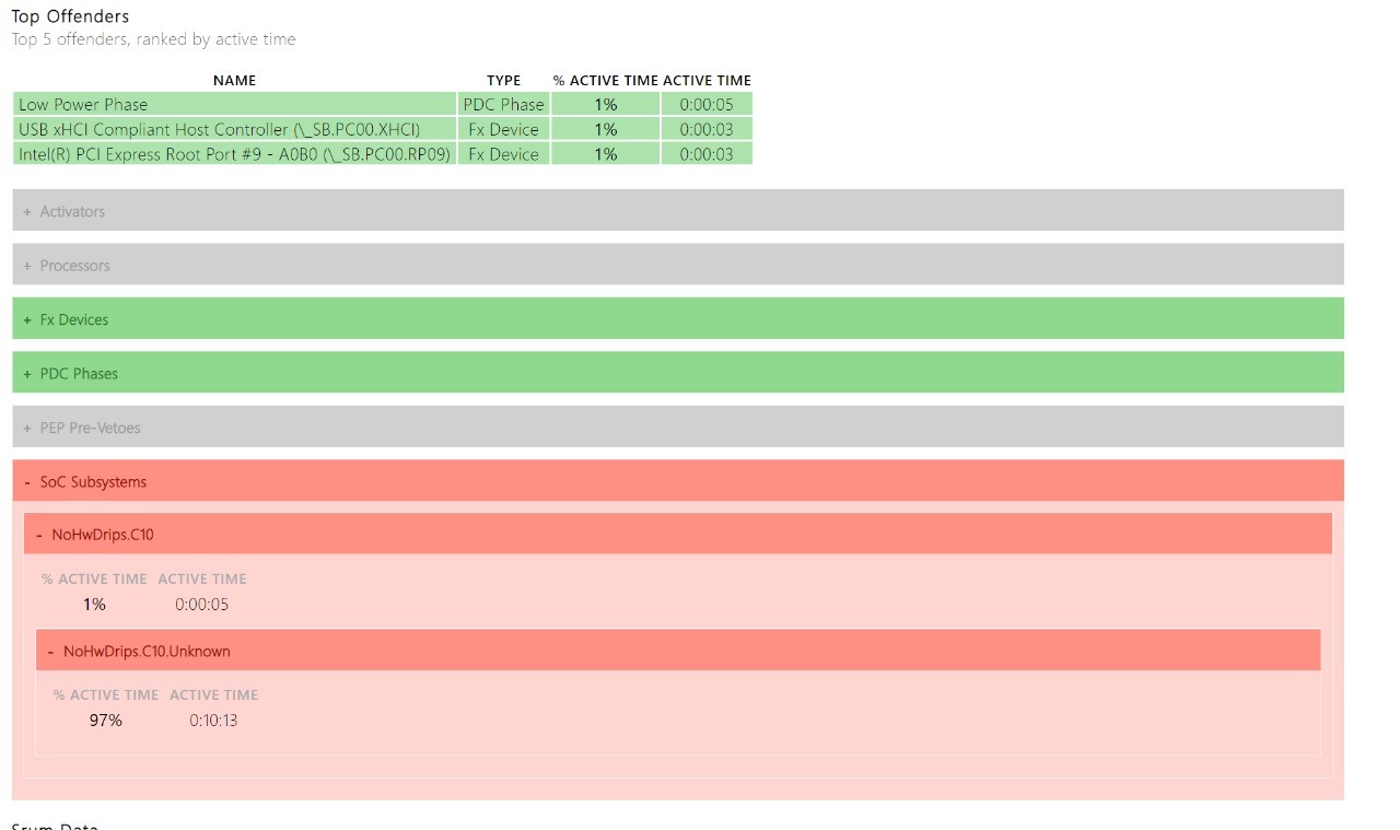

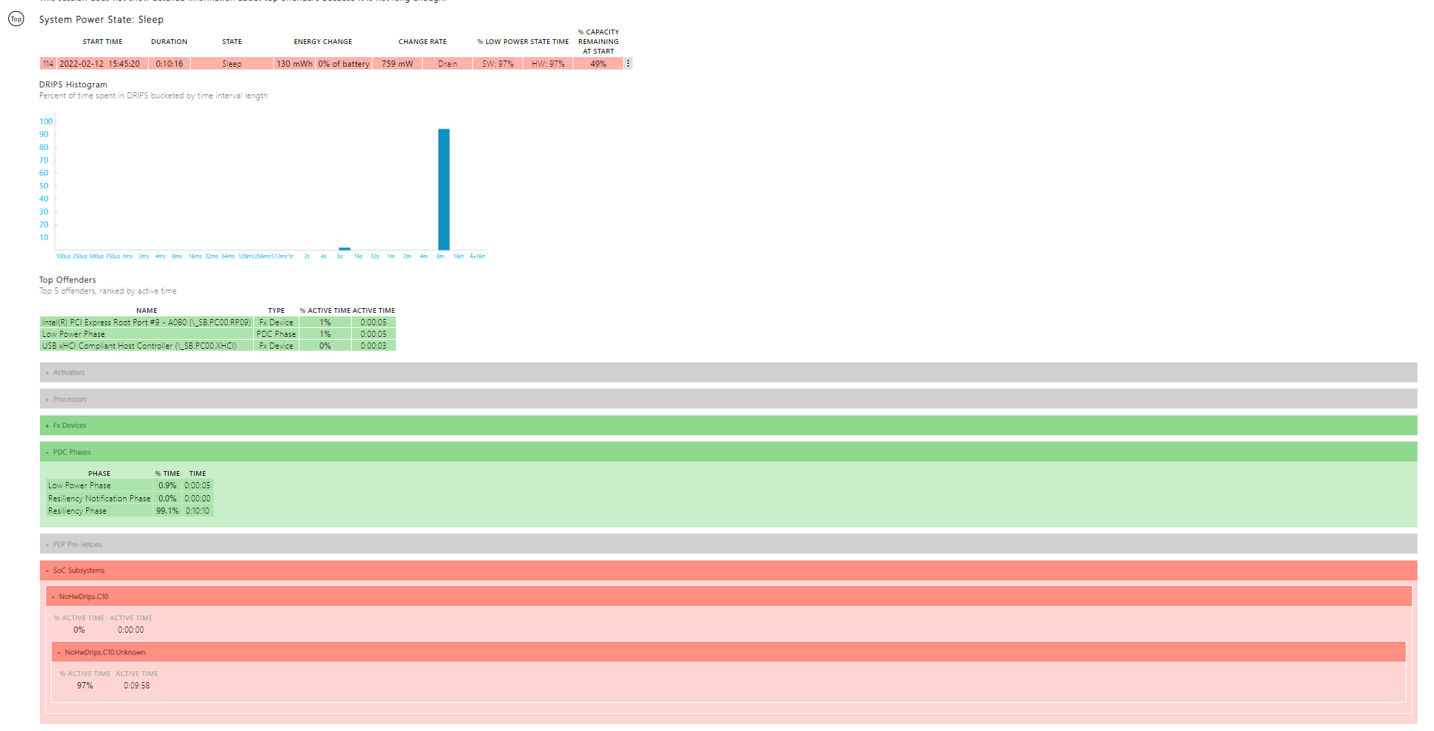

    Thank you Bernard for the detailed reply, It took me time to try out these solutions
    I tried the three methods in order, but none of them has solved the draining during sleep (SoC subsystems NoHwDrips.C10.unknown) it remained consistent

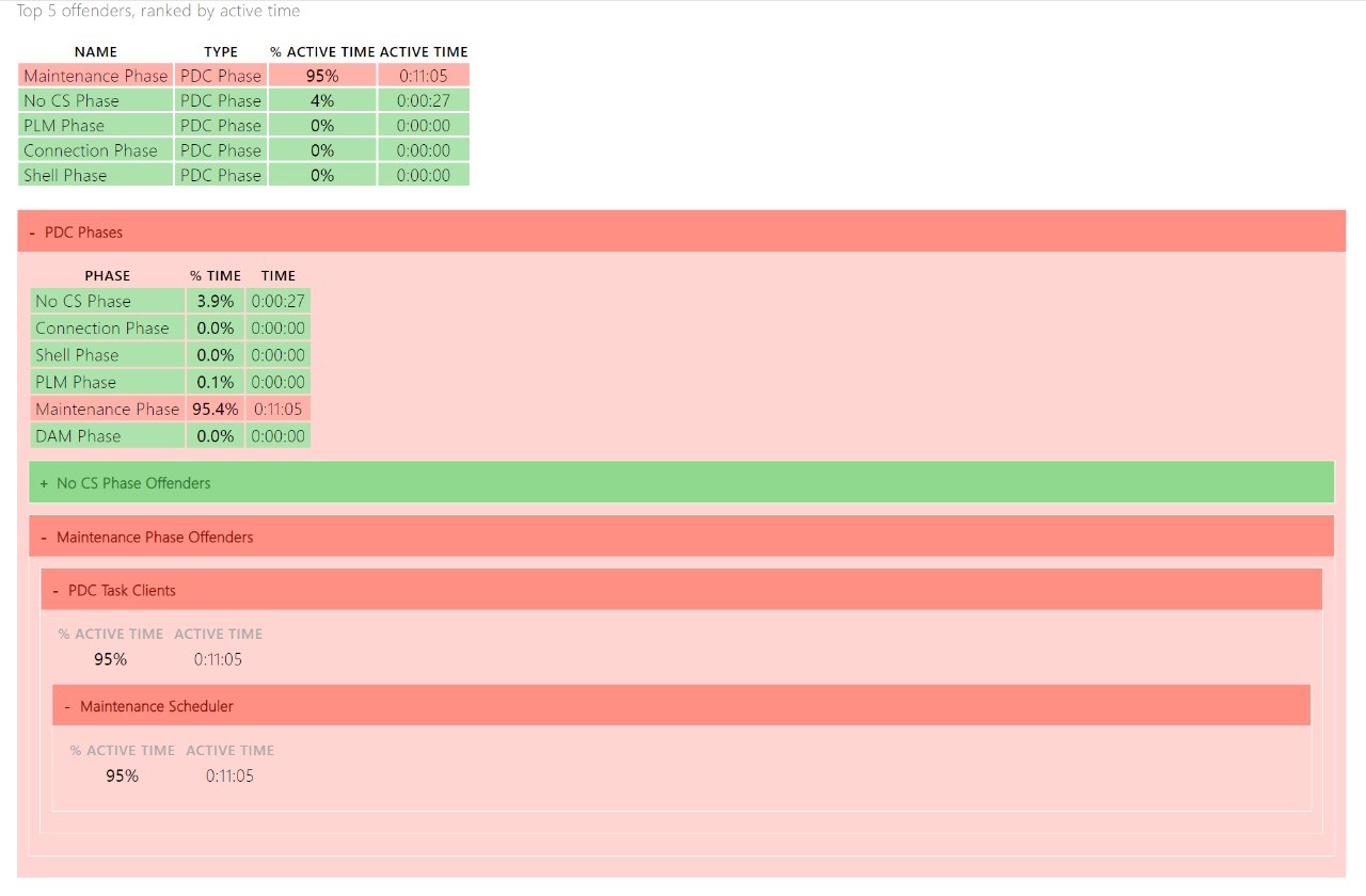

    I haven't tested "Maintenance phase offenders (PDC Task Clients --> Maintence Scheduler" as it is an offender during screen off while the laptop is charging
    These offenders showed after trying method 1 (uninstalling battery drivers)
    ![](https://learn-attachment.microsoft.com/api/attachments/c512b569-50c2-4dc7-b96e-0398bbee6305?platform=QnA
    and SoC subsystems NoHwDrips.C10.unknown remained as an offender draining during sleep after trying all methods for an active time almost 100% (the result were the same either sleep duration is long or short)
    ![](https://learn-attachment.microsoft.com/api/attachments/db58614a-6583-44a9-9933-6b0bc83ac7bf?platform=QnA
    I should mention that while trying safe boot method (number 2), I couldn't disable avast antivirus from start-up
    So, does this mean it could be a hardware problem with the battery not a software problem?
    thanks
