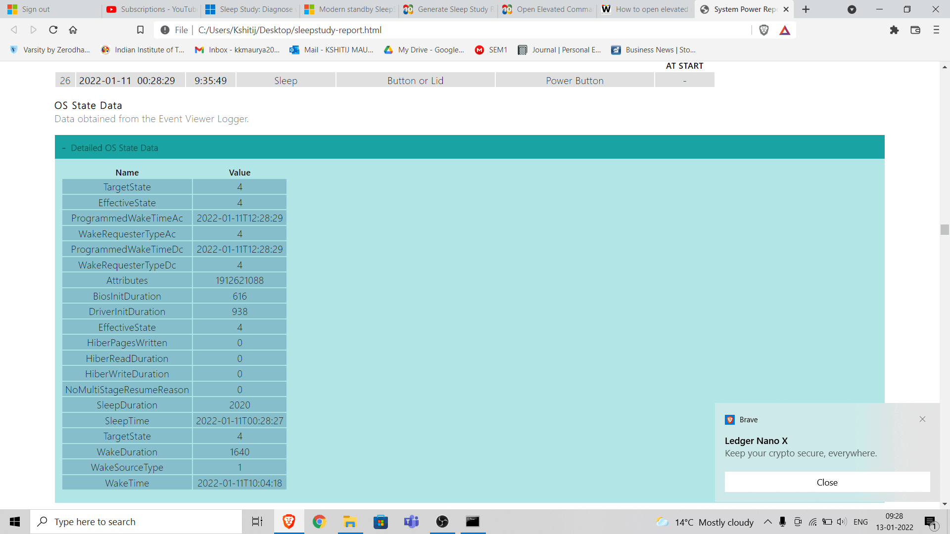

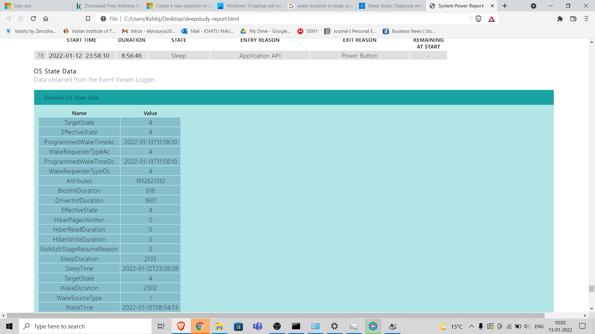

    2022-01-13T04:39:15+00:00
    My laptop seems to drain about 40-50% battery overnight on sleep some days.
    The sleep study reports of my laptop are attached below. The first image is of when the battery got drained and the second image is of the day when it didn't.
    I'm not able to figure out what is actually causing the issue.Pls look into the images and provide a fix to this issue.
