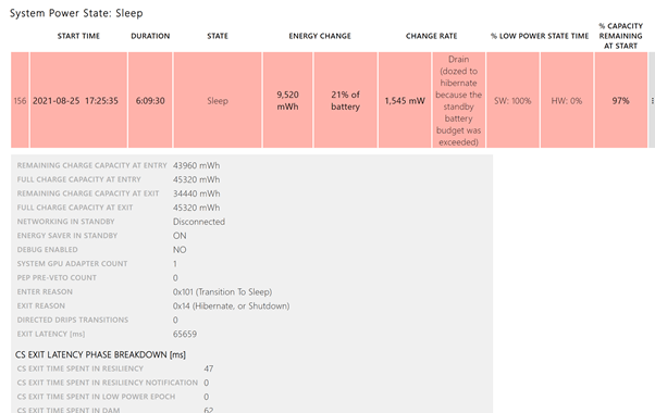

    I have a problem with my Microsoft Surface Pro 7 running on Windows 10 Home when closing the lid (putting it in sleep mode, not hibernation). The problem seems to mainly appear after having it connected to an HDMI device/beamer. The laptop experiences a significant battery drain during that time when it is in sleep mode - to the extent that it always shuts down completely with 0% battery life left if I don´t charge it before. I have performed multiple sleep study reports, and the problem always seems to be connected to some SoC subsystems and NoHwDrips...whatever that means...but it basically leaves the laptop 100% active during a time where it should "sleep". (see screenshot below)
    Initially I thought this issue would have to do with the computer still being connected to WiFi - but I disabled that function already during sleep, so that can´t be the issue anymore. Does anyone have any advice for me on how to solve this issue? It´s super annoying... Thanks in advance,
  5. DaveM121 931.8K Reputation points Independent Advisor
    2021-08-26T09:22:12+00:00
    Hi Niki1979
    I am Dave, I will help you with this.
    This is normal, in Sleep Mode, the battery is still powering the components of your device, like RAM, Processor, video card SSD... etc. there is no way to stop battery drain in Sleep Mode, your device will eventually turn off if the battery drains.
