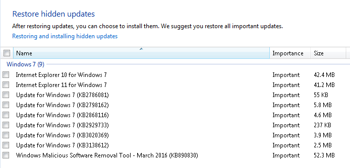

    I should have added....
    When doing a rebuild, allow any and all non-security updates dated before January, 2015.  Hide all after that.

    2016-03-11T22:33:38+00:00
    Yea this is the one that poked the pooch
    https://support.microsoft.com/en-us/kb/3020369
    This one has to be installed all by it's self but is checked at least it was for me along with 158 others :p
