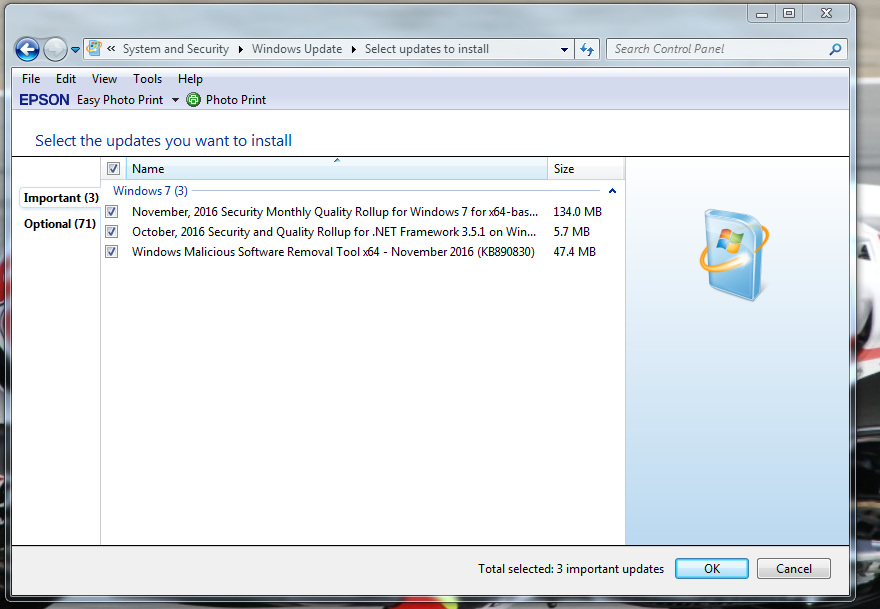

    Hi @ ShaneFletcher  ,
    What Windows 10 Malware? I see no Windows 10 Malware. What you pictured, I installed yesterday with no bad effects, whatsoever.
    I always check for New Security Updates. Never had to do a Clean install again. Everything is working fine.
    And I do use Acronis True Image 2017 to do an image before Updates and if no ill effects, do an image afterwards.
    http://www.acronis.com/en-us/personal/computer-backup/
    2016-11-13T09:43:22+00:00
    Hey VZ,
    I have been running win7 SP1 64 after a fresh install for months now and I have followed all the info on here with the rollups provided and I must say my win7 OS was working perfectly with no win10 malware insight. As I don't know much about computers and im just a general user who picked up a lot of help from you guys on here to keep win10 at bay I think ive messed it up again.
    Now you'll probably call me for doing this but yesterday out of curiosity i turned my WU back on just to see if Microsoft had changed the roll up config so that we could no longer chose our preferred updates alone, and in doing so I allowed MS to install a critical update in the background and im now having problems with my OS.
    Heres a picture of the available Win10 Malware updates above.
    Some of the problems im having is with the ram on my PC i have 4g ram and with nothing open in my desktop my usage is at 50% plus and wont reduce and also my pc is running slower than normal. I know you and many others said never to check for updates ever again after the Junes rollups but I was worried about not receiving any security updates for the future.
    I have checked the services in task manager and hid all MS applications and stopped all the rest but nothing seems to work. Should i now perform another fresh install and just run the rollups from your advice above? how can I stop the new rollups in October and November from installing once ive done a clean install. I cant see how I can rectify my silly mistake I should have left it alone, as you cant reverse a critical update that you cant see.
    Hope you can help me out again thanks for reading.
    Best Regards
