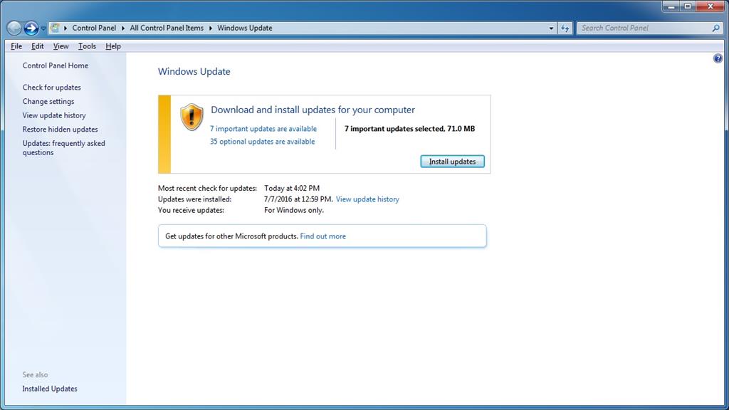

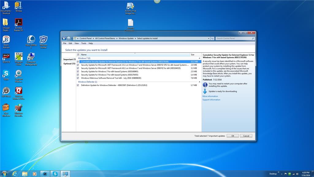

    Once again I find myself relying on this thread.  I first posed my affliction with this problem back in April.  The step by step solutions did eventually rectify the WU constant cycling.  Now it is July, and I was back in the same boat once again.  Even the standalone downloads wouldn't install- the installer just continued "searching for updates"! (Why are they .msu files anyways? Why can't they just be .exe's?? Anyways...) I have gone through the steps of stopping the WUI through Services, downloading KB3020369 and 3161608, installing, etc etc.  My WU has now effectively located 14 important updates and 47 optional ones.  Here's my question:  I understood from "askwoody" comments that 3161608 was only listed as an optional... WHY, if it was necessary to complete this painful process of repairing the WU function? And, if IT was optional, how is the common person like me with no formal computer training in any of this to know WHICH other optional downloads I should select for my own?

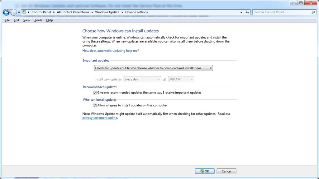

    Hi @SueQKY ,
    Change Windows Update Setting to "Check for updates but let me choose whether to download and install them." And for get this setting and leave it there.
    You can pick and choose which updates to download and install. You can also click on More Information on the right side before deciding.

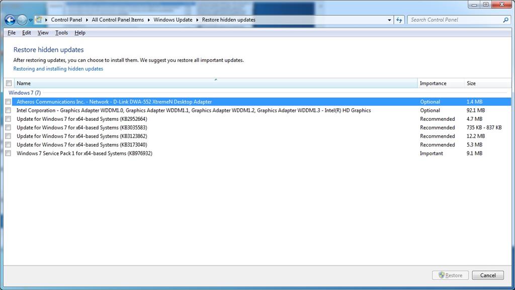

    The updates that you don't wish to install, can be hidden.
