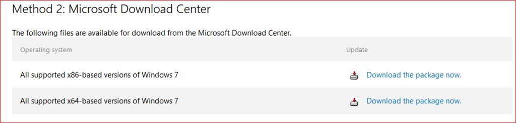

    2016-04-25T13:41:56+00:00
    This is what the 32 bit x86 download page looks like. Notice that it does not give any indication or choice as to which version this is.  If you want 64 bit, and you specify that in your search, you will see page that specifically says it is a 64 bit version.  If your search does not specify you get this page.
