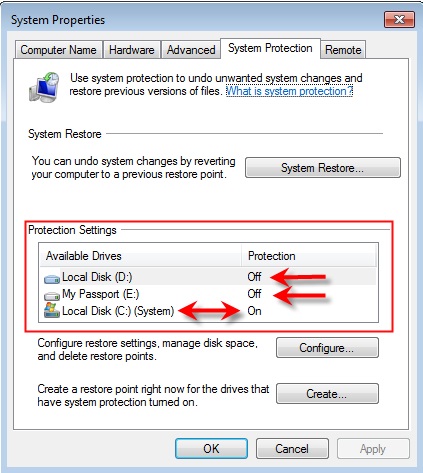

    Turning off system protection on the external drive (a good idea)
    System Protection should really only be enabled on your system drive anyway:

    Did you check/adjust the System Protection Properties so only your system drive is monitored?  That seemed to work for a couple people.

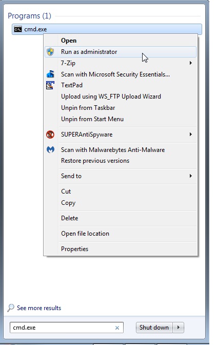

    For the experiment first open a command prompt as Administrator:
    Then run each of these command separately and tell us what they say:

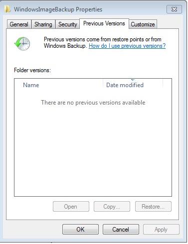

    One probably last thing from me for today.
    I created a Windows backup with System image on my D drive and right clicked the folder called WindowsImageBackup and and chose to 'Restore previous versions' and there are none (because that drive is not being monitored):
    What does yours say?
