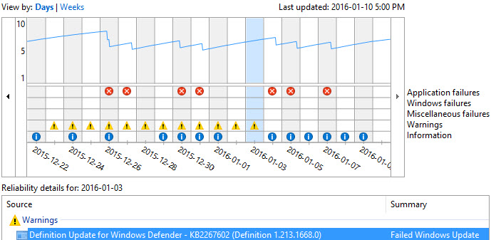

    2016-01-10T23:31:49+00:00
    Thanks for this fix, although it looks like our ranting may have paid off. I've not made any changes or attempted your fix but the annoying update failures for Windows Defender seem to have stopped for me on January 4th, as you can see from the reliability monitor output below....
