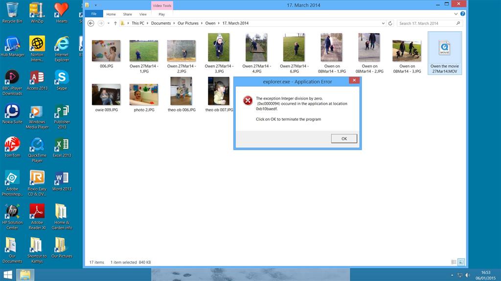

    Having just tried again to open a .MOV file from Windows Explorer I have received a new error message as follows:
    Hope this provides useful additional info for Microsoft to pin down the source of this problem.

    In my reply above I inserted a picture of the error message as displayed by Windows but it's not showing so I'll try again
    2015-01-07T05:53:51+00:00
    Just realised that the detail in the error box is a bit fuzzy and so hard to read so I've transcribed it below:
    The exception Integer division by zero.
    (0xc0000094) occurred in the application at location
    0xb10baedf.
    Click on OK to terminate the program
    Hope this helps Microsoft to get to the root of this long-standing problem.
    Thanks, Tony
