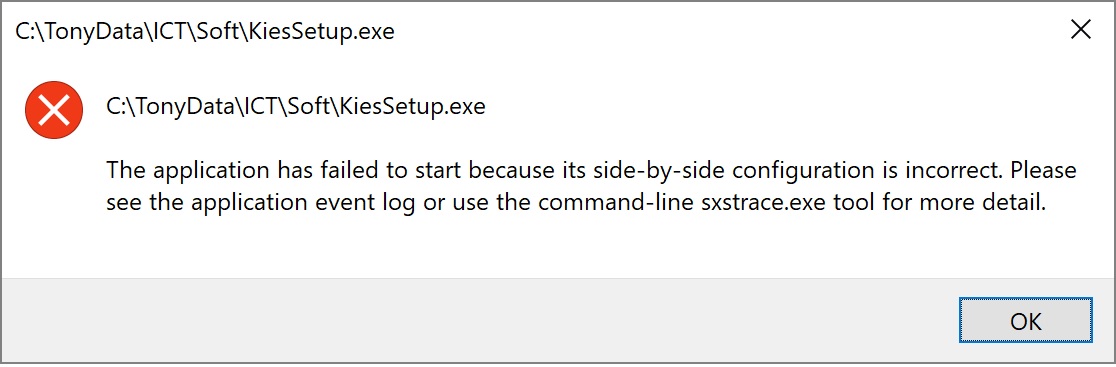

WINDOWS 10 Pro error The application has failed to start because the side by side configuration is incorrect please see the application event log or use the command line sxstrace.exe tool for more detail.
I am getting the error "
"WINDOWS 10 error The application has failed to start because the side by side configuration is incorrect please see the application event log or use the command line sxstrace.exe tool for more detail." for every application that i try to launch.

    I tried all of the above suggestions and still have error message c:\Program Files (x86) \ Google\Chrome\Application\chrome.exe
    The application has failed to start because its side by side configuration is incorrect.
