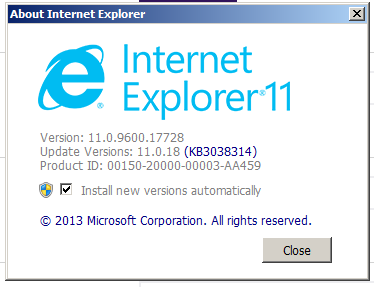

    Exactly. If KB3038314 appears after the updated version number, all should be well...
    2015-04-21T20:02:14+00:00
    If you see the kb3038314 after the updated version number, it should be ok..hide the update....

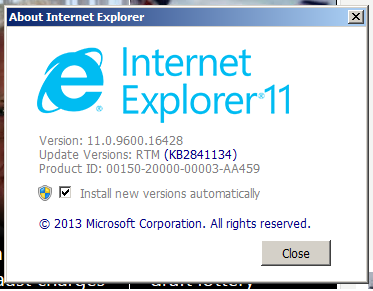

    6- Going to the about tab of ie11, you should have update version KB2841134 installed
    7- go to the windows update pannel, scan for new updates and install them. you will will notice that the KB3038314 and after a little while, you will have this update succeded
    8- Reboot when asked
    9- You now have ie11 with last update as the about tab shows and windows update not failing anymore that annoying update.
