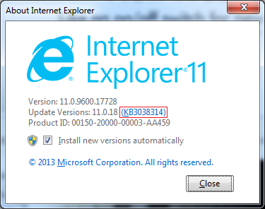

    I can confirm that if IE11 Help->About shows KB3038314 as below (minus the red outline):
    then the correct binaries to patch the MS15-032 vulnerabilities are installed.  So, if your concern is being vulnerable to MS15-032, you are not.
    If the fact that WU thinks you have uninstalled security updates is causing headaches in and of itself, then you should wait for the official fix.
    I did try some of the patch juggling described in various posts (late) last night on a VM and was not successful.  Note that in trying these work arounds you are stepping off the beaten path.  Prudent counsel would to wait for the official fix, especially in light of not actually being vulnerable.
