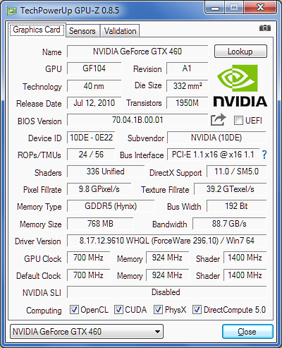

    Don't know why, here is a screen shot of my system and BIOS is displayed.
