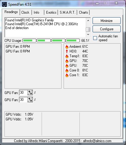

    1- I only have CoolSense tool which can only be set up to be ON or Off.   No other setting options can be done to adjust the speed to lower the temperature.. I really have not seen any noticable benefits from this CoolSense tool at all. I don't know if this tool is  fan speed software or not? If not, then have you any other software?
    ![](http://fud.community.services.support.microsoft.com/Fud/FileDownloadHandler.ashx?fid=257812a0-1878-403f-bca9-9c0958a9797a)
    2- I have run the SpeedFan tool, and I have sent its test results to you. Have you seen it? I do think it is just  fan fan speed-monitioring software, and it is not  fan speed software?

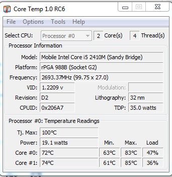

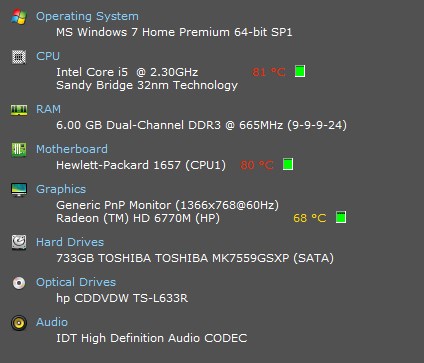

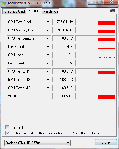

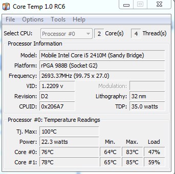

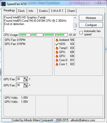

    I have purchased a new fan/ heat sink Assembly from eBay, and unfortunately the heat sink was not fitted to my motherbooard.(i.e. it wasn't mounted to the CPU and GPU). However, only the fan was similar to my old fan. So, I took out(removed) my old fan from my old heat sink, and after taking  the new fan from my new heat sink, I installed the new fan in-place my old heat sink very well.
    Then, I used a material including alcohol(I was told that it has 100% of alcohol). I used a clean tight cloths to apply some of alcohol to remove the old thermal compound from the CUP, and GPU, and the contact surfaces to CPU and GPU. Then, I let the CPU and GPU to dry. After that, I apply new thermal Compound of my same thermal compound which is not sliver with following your way to apply the new thermal compound.

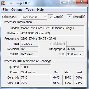

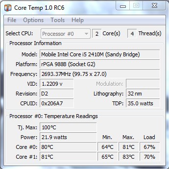

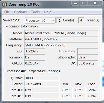

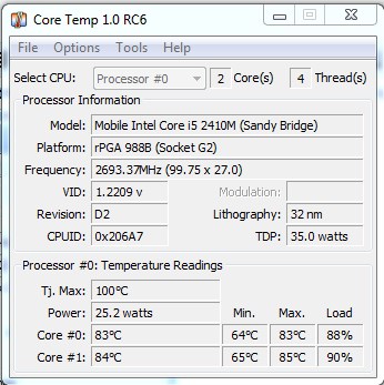

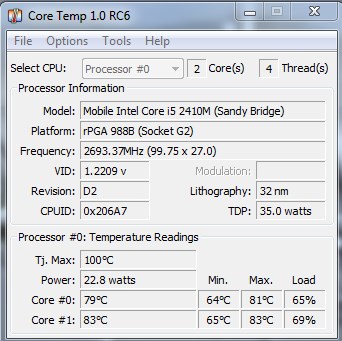

    While my computer is in load(not Idell) (about three streaming videos are playing on Youtube.com, and two videos stored on my HDD are played by Media players installed on my PC.   However, although the error "'The system didn't detect that a cooling fan is operating correctly'" is no longer appearing to me, the CPU and GPU temperatures, I think according to the screen shots below, are still way to hot. The fan is well blowing out hot air from the events
    These are the screen sthos were taken from time to time but in about the same load
    Speccy:
    GPU-Z:
    SpeedFan:
    By the way, the new fan/heat sink NOT suitable to be in-place my old fan/heat sink was applied with a thermal compound by vendor. Is it reasonable?
