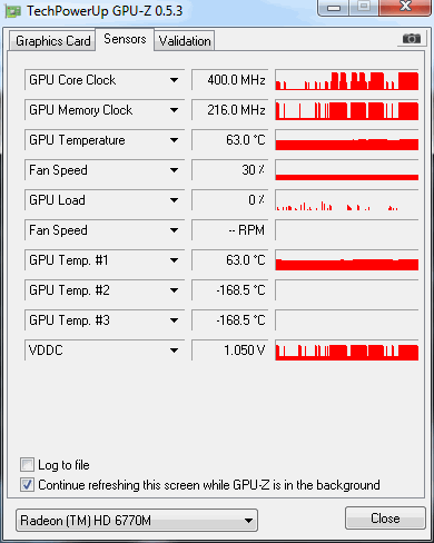

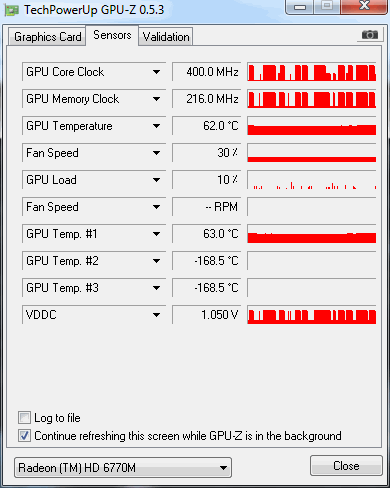

    1- Although the GPU and  CPU  temperatures are not high at all(screen shot below), I found out sometimes I have been encountering the error message below specifically when trying loading websites with Firefox browser. Even while the website loading with Firefox is not responding, this error below appears. And once this error disappears, then the website opens well.
    "Display driver stopped responding and has recovered"
    **Uninstall and re-install the display driver (Use device manager) OR post the issue to the Firefox forum:**https://support.mozilla.org/en-US/kb/get-community-support
    ![](http://fud.community.services.support.microsoft.com/Fud/FileDownloadHandler.ashx?fid=7ae2c6b9-60d5-4efe-a4b9-c8a35e429816)
    ![](http://fud.community.services.support.microsoft.com/Fud/FileDownloadHandler.ashx?fid=50fc9e1c-cb63-45be-ac1b-c4278e242382)
    ![](http://fud.community.services.support.microsoft.com/Fud/FileDownloadHandler.ashx?fid=82a83114-dec5-4867-adbe-4097429df846)
    Yes, I have checked my HP manufacture web, and I didn't find any newer driver of GPU than my driver installed.
    Also, Firefox has only Skype add-on added. Do you think this is the reason. But if so, I would be facing with Google Chrome and MS IE since this 'Skype add-on' added as well. Check to see if you have the latest version of Firefox (version 47 I think)

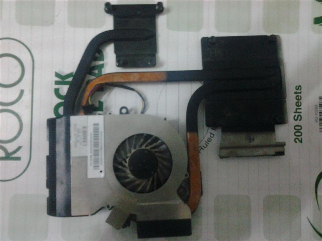

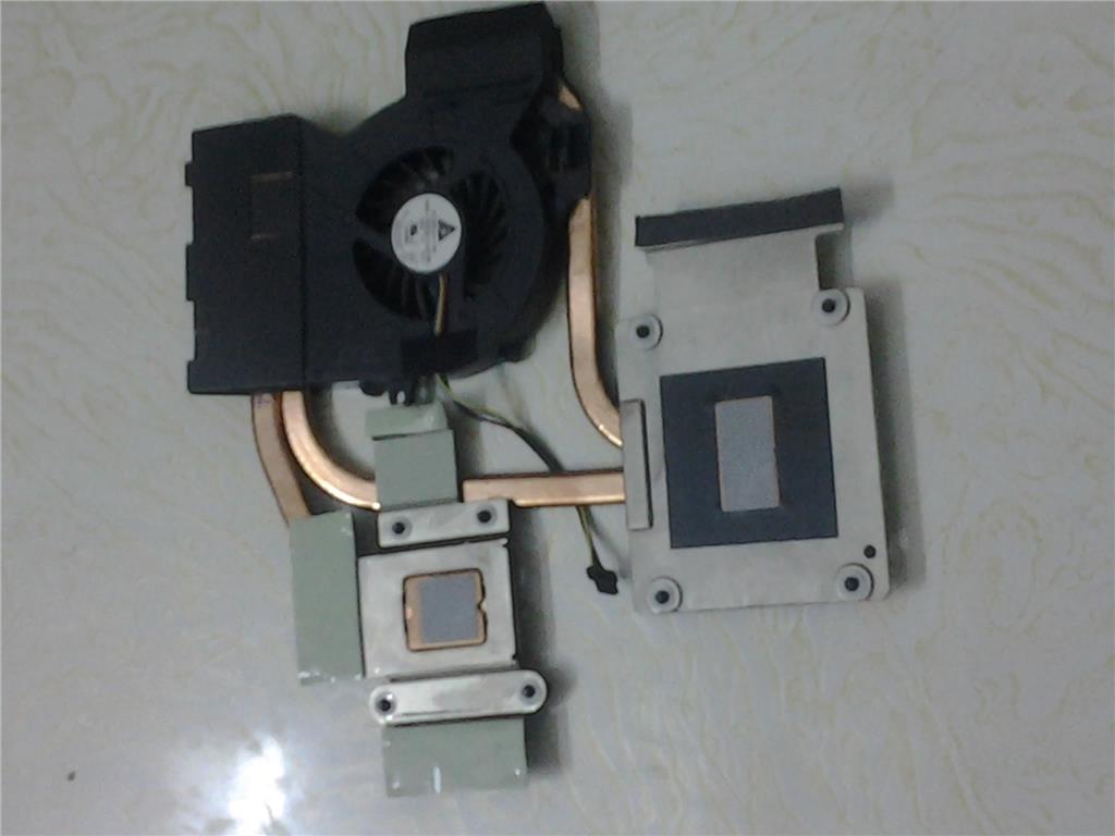

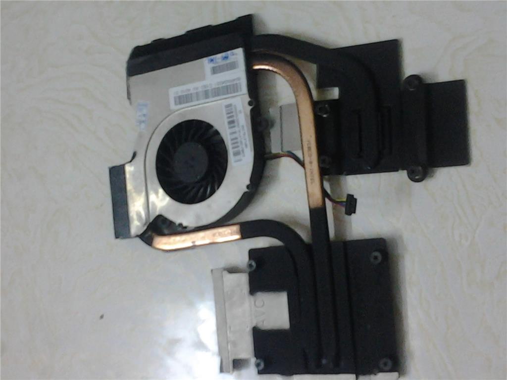

    2- do you know why only the fan removed from the new fan/heat sink assembly was fitted to my old fan/heatsink?
    NO.
    3- From the screen shots below, do you think you can distinguish the difference between the  old fan/heatsink and new fan/heatsink (why is the new fan/heat sink not fitted to the old one?).
    Although I have sent the spare part number of my old fan/heat sink to the seller before purchasing the fan/heat sink that I need, unfortunately the new fan/ heat sink assembly purchased from eBay was not fitted to my motherboard.(i.e. it wasn't mounted to the CPU and GPU). However,  only the fan was similar to my old fan. So, I took out(removed) my old fan from my old heat sink, and after taking  the new fan from my new heat sink, I installed the new fan in-place my old heat sink very well. GPU heat sink looks different
    These are two faces for the old fan/heat sink:
    ![](http://fud.community.services.support.microsoft.com/Fud/FileDownloadHandler.ashx?fid=d3ae8b08-8bb2-42c5-b476-3f7779ff4d82)
    ![](http://fud.community.services.support.microsoft.com/Fud/FileDownloadHandler.ashx?fid=7054dee6-b8b7-4673-9423-1b80b2a0d8d0)
    These are two faces for the new fan/heat sink purchased from the eBay:
    ![](http://fud.community.services.support.microsoft.com/Fud/FileDownloadHandler.ashx?fid=f143482a-7763-4722-939b-5282fe9f922f)
    ![](http://fud.community.services.support.microsoft.com/Fud/FileDownloadHandler.ashx?fid=cab7d1b1-dbfe-4bdc-85e9-383f3f75c233)
    4-  As you said it is a common practice to have a pre-applied pad of thermal compound on the new heat sink.  So, when I apply new Thermal Grease/paste onto the CPU and GPU surfaces, and mount the one heat sink to the CPU and GPU, then the mount of thermal compound would exceed the required limit.
    The two compounds are of different types and using both may reduce the heat transfer from the CPU to the cooling assembly. The result would be higher temperatures. Use on or the other but not both !

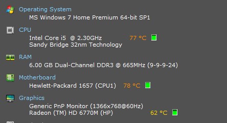

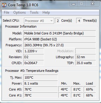

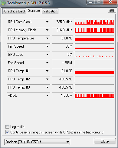

    I was NOT running many streaming videos. However, all what I was running four streaming  videos.(two on Youtbue.com, and two videos saved on my HDD and palyed with my media player installed on my Windows
    Now, this results below was taken while running one video saved on my HDD and palyed with my media player installed on my Windows, and two on Youtube via internet.
    ![](http://fud.community.services.support.microsoft.com/Fud/FileDownloadHandler.ashx?fid=983abe26-82cc-4f0f-9e8f-eca0557d34c0)
    ![](http://fud.community.services.support.microsoft.com/Fud/FileDownloadHandler.ashx?fid=43352393-db71-44d3-9ee2-60312c759710)
    ![](http://fud.community.services.support.microsoft.com/Fud/FileDownloadHandler.ashx?fid=67122967-bb4b-4f31-b92d-975047f406a4)

    2- Although I have sent the spare part number of my old fan/heat sink to the seller before purchasing the fan/heatsink that I need, unfortunately the new fan/ heat sink assembly purchased from eBay was not fitted to my motherbooard.(i.e. it wasn't mounted to the CPU and GPU). However, only the fan was similar to my old fan. So, I took out(removed) my old fan from my old heat sink, and after taking  the new fan from my new heat sink, I installed the new fan in-place my old heat sink very well.
    ![](http://fud.community.services.support.microsoft.com/Fud/FileDownloadHandler.ashx?fid=e5078ddf-6ee7-4bad-9bef-124cf4314c7d)
    ![](http://fud.community.services.support.microsoft.com/Fud/FileDownloadHandler.ashx?fid=154397a6-56ec-4cd5-9d9e-190b95aacf17)
    3- By the way, the new fan/heat sink NOT suitable to be in-place my old fan/heat sink has been pre-applied with thermal compound by vendor. So, all what I need to do is applying new thermal compound onto the CPU and GPU, and mounted Fna/heats sink onto the CPU and GPU. But do you think it is reasonable there is a pre-applied thermal compound on the new heat sink?

    Your graphics is too hot, but that could be becasue you are running multiple streaming or you did not apply the thermal paste correctly. ZP-360 is not the best thermal compound to use which could also be a problem.
    Try running a single steaming video and post back your results.
    J W Stuart: http://www.pagestart.com
