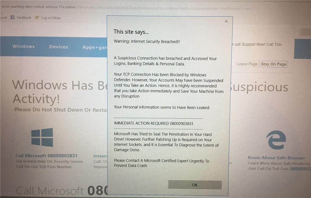

After navigating to a web page, a popup hijacked the Edge browser.
The popup is a false virus warning, with audio, that repeats endlessly.
I used Task Manager to close Edge browser, but after re-opening, it returns to the hijacked page.  There is no time to open another tab, or reach settings.  How can this be cleared.

When this happened to me, I closed Microsoft Edge using the Task Manager.
Then in the search bar next to the Windows 10 logo on the bottom off the screen (I call it the "Cortana Search"), I typed in google.com and hit enter.
Microsoft Edge opened up with a new tab for Google.  You can see the offending site still opens in a tab that doesn't have focus.  Click the "X" to close Edge. Do not click on the offending site tab or it will get focus again.
When Edge closes nicely, I won't "Restore" the sessions and the offending site tab will be gone.

It's a common scam. Click the OK button at the bottom of the popup. You should then see a box Do not allow this site to create new messages. Check it and then close the window.
If that doesn't work, for Edge, follow the instructions by Scott_Ki here:
https://answers.microsoft.com/en-us/protect/forum/protect_other-protect_scanning/edge-frozen-with-virus-warning-popup/7212a393-90ad-48d0-ab55-4ffe1f21a554?page=2&msgId=7618ae67-bf16-4155-bf90-d8a7405ee199
For all other browsers, use the Task Manager to exit the browser. Reboot and see if the pop-up goes away.

    I got the same menacing problem with my edge, in my windows 10 PC.
    What I did to avoid it;
    1. "End now" with the task manager
    2. Open the edge again and tried to close it even  before it loads..
     Keep pressing ctrl+w (close)
    it would go away
    i had it two times.
