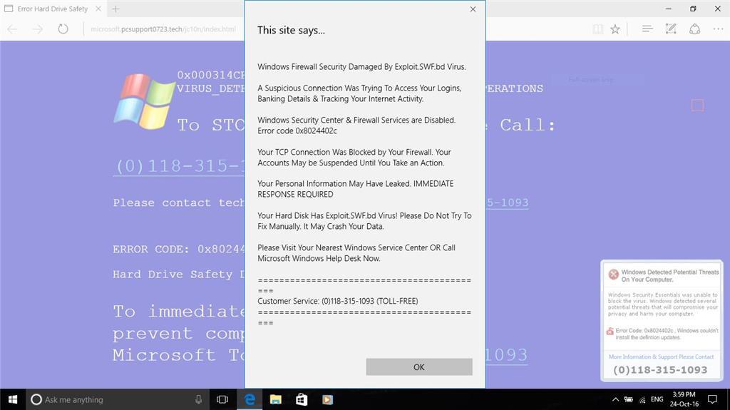

After navigating to a web page, a popup hijacked the Edge browser.
The popup is a false virus warning, with audio, that repeats endlessly.
I used Task Manager to close Edge browser, but after re-opening, it returns to the hijacked page.  There is no time to open another tab, or reach settings.  How can this be cleared.

When this happened to me, I closed Microsoft Edge using the Task Manager.
Then in the search bar next to the Windows 10 logo on the bottom off the screen (I call it the "Cortana Search"), I typed in google.com and hit enter.
Microsoft Edge opened up with a new tab for Google.  You can see the offending site still opens in a tab that doesn't have focus.  Click the "X" to close Edge. Do not click on the offending site tab or it will get focus again.
When Edge closes nicely, I won't "Restore" the sessions and the offending site tab will be gone.

This did not work. It closed the offending page, but when I re-opened Edge it popped back up again.
It's a common scam. Click the OK button at the bottom of the popup. You should then see a box Do not allow this site to create new messages. Check it and then close the window.

    How I resolved this issue:
    1. Close the Edge windows using task manager.
    2. Open the Network and Sharing Center
    3. On the left, select Change adapter settings.
    4. Select the active internet connect and then disable it.
      1. (There are other ways to disable, but I find this to be the fastest method from the desktop)
    5. Launch Edge again, the virus warning page will try to start up, but fail.
    6. Close all tabs.
    7. Re-enable your network adapter (Or otherwise connect back to the internet).
    8. Launch Edge.
    This should find the problem.  It appears that Edge stores the page session when Edge is closed by task manager and this is why it is difficult to get rid of this page.  I hope this helps someone.
