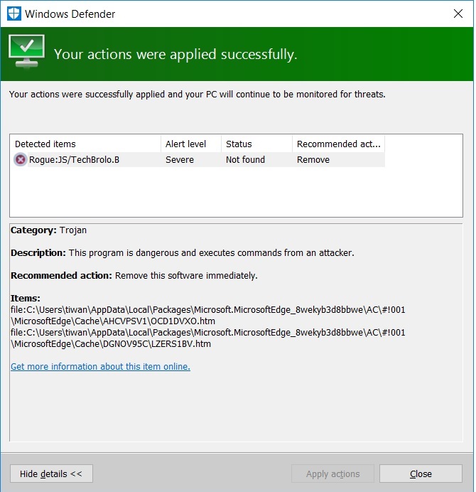

    Just got the same problem today when I tried to check out the flight status of my friend and probably clicked on some bogus/imitation link of the airline site. I followed your steps and it worked. I also followed steps form another post to clean all the browsing histories.
    I then continued with a Windows Defender *full* scan and there is really a Trojan horse type virus in the edge browser's cache area. I was able to clean it with the windows defender.
    My point is that you should run a full system anti virus scan and don't take the problem lightly!
