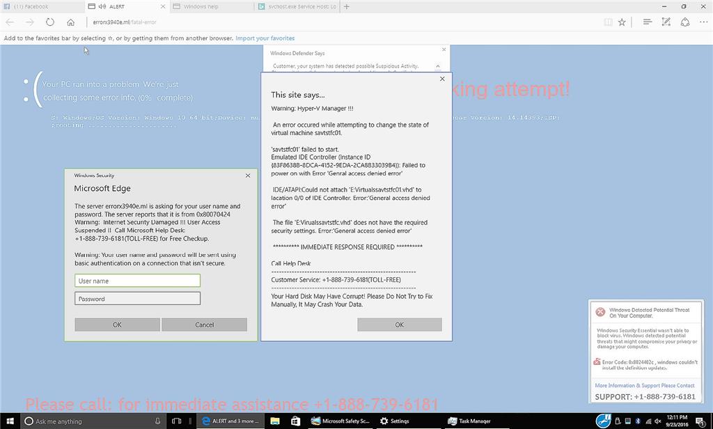

    My wife hit a link from a Facebook post, something about a soldier teaching somebody a lesson?  This "Virus warning popped up from Windows 10 Edge, but Windows Defender and msert scans using the maximum scan settings, found nothing.  I'll clear her cache when I finish my cigar and go back in the house.  I didn't see where anyone else had posted a picture of this version, but I did NOT read every post so...  This one had a mouse moving about the screen and text scrolling in the background.
    It reminded me of a page I had on my web site that "appeared" to open a dos box and run a del /s on c:, automatically respond to the "are you sure" question with a "Y" for yes and then it would start scrolling through a ton of file names, "appearing" to wipe your files from c:.  Then it would "appear" to start a Mac OS install.  It amused some friends, scared the daylights out of others.  I added a "NOT REALLY" line to the end of it, but it took a few minutes to run and a few people would not wait that long so I took the page down to avoid causing them problems. o.O
    Now to block errorx3940e.ml until they come from the next one...
