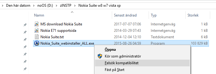

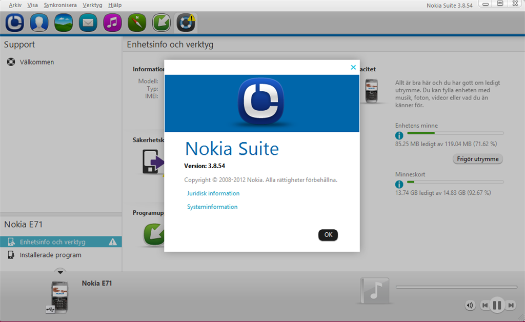

    I couldn't get Nokia Suite to work on Windows 10, but after a recovery of Windows 10 pro I right-clicked on the Nokia Suite install file and instead of "Run as administrator", I choosed "Troubleshoot compatibility" (at least that's what I think "Felsök kompatibilitet" should be translated to from swedish), I went through the wizard with default choices and presto, Nokia Suite is working fine! I can sync my Nokia E71 with Outlook 2010
    Bluetooth adapter is broken on my PC so I connected my phone with USB and then Windows installed USB drivers automatically (took long time, several minutes).
    The Nokia Suite version successfully installed on my PC is 3.8.54:
    I hope this will work for you also!
