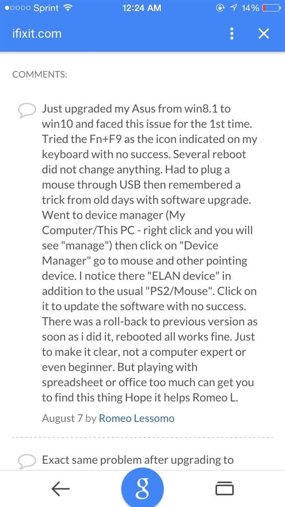

    I had the same problem. This started when I couldn't use two fingers to scroll the touch pad as i used too, i tried Elan Drivers, and when they didn't work. I attempted to install them. I ended up here.
    I connected an external mouse, then i went to Device Manager, i could see the keyboard and mouse with a driver "Lenovo Ps2 something"...
    I uninstalled this drivers, for both the mouse and the keyboard, then set an automatic scan online for new hardware devices and drivers. This fized my problems. Hope you find this useful too.
