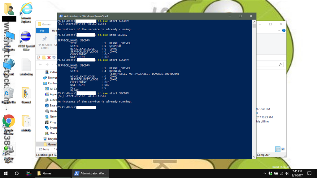

    2018-02-17T23:55:28+00:00
    I think the default service start configuration is demand start (manual).
    sc.exe start secdrv
    will again start the driver.
    You can configure it to automatically start after every boot as follows
    sc.exe config secdrv start= auto
    You can find out what the start type is with the 'query configuration' command:
    sc.exe qc secdrv
    Not having secdrv started only protects you from issues with the driver itself. You might still have software that runs elevated simply start the driver and exploit your system from there. You will also still be vulnerable from having secure boot disabled.

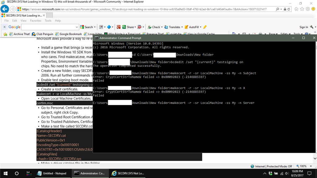

    2018-02-18T14:35:55+00:00
    Microsoft does provide a way to re-enable SECDRV.
    • Install a game that brings (a recent version of) SECDRV.sys.
    • Install the Windows 10 SDK from Get the standalone Windows 10 SDK. Just install all components, cuz who cares.

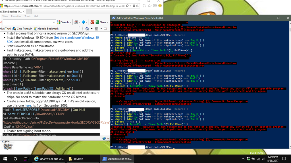

    • Start PowerShell as Administrator.
    • Find makecat.exe, makecert.exe and signtool.exe and add the path to your PATH:
    dir -Directory -Path 'C:\Program Files (x86)\Windows Kits\10' -Recurse |
    where BaseName -eq "x86" |
    where { (dir $_.FullName -Filter makecert.exe) -ne $null } |
    where { (dir $_.FullName -Filter makecat.exe) -ne $null } |
    where { (dir $_.FullName -Filter signtool.exe) -ne $null } |
    select -First 1 |
    foreach { $env:Path = "$env:Path;$($_.FullName)" }
    • The ones in a x86 subfolder are always OK on all Intel architecture chips. No need to match the hardware or the OS bitness.
    • Create a new folder, copy SECDRV.sys in it. If it's an old version, use this one here. Its from September 2006.
    mkdir "$env:USERPROFILE\Downloads\SECDRV" | Out-Null
    cd "$env:USERPROFILE\Downloads\SECDRV"
    • If it's an old version, use this one here. Its from September 2006.
    curl -UseBasicParsing -Uri "https://github.com/ericwj/PsSecDrv/raw/master/tools/SECDRV/SECDRV.sys" -OutFile "SECDRV.sys"

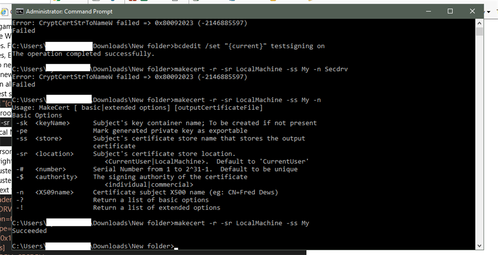

    • Enable test signing boot mode.
    bcdedit /set "{current}" testsigning on
    • Pick a subject for the certificate.
    $Subject = "SECDRV.sys signing for $env:USERDOMAIN$env:USERNAME on $("{0:dd-MMM-yy HH:mm}" -f [datetime]::Now)"
    • Create a root certificate.
    makecert -r -sr LocalMachine -ss My -n "CN=$Subject"
    • Open Local Machine Certificates.
    certlm.msc
    • Go to Personal, Certificates and select the certificate created, there usually is only one, or match the subject, right click Copy.
    • Go to Trusted Root Certification Authorities, Certificates. Paste.
    • Go to Trusted Publishers, Certificates. Paste.
    • Make a text file called SECDRV.cdf in the folder and put this in it.
    [CatalogHeader]
    Name=SECDRV.cat
    PublicVersion=0x1
    EncodingType=0x00010001
    CATATTR1=0x10010001:OSAttr:2:6.0
    [CatalogFiles]
    <hash>SECDRV=SECDRV.sys
    • Make a driver catalog file in the folder.
    makecat -o SECDRV.txt -r SECDRV.cdf
    • Sign the driver. Use the thumbprint as shown in certlm for the certificate created, just double click it and look around, without spaces. Or get it in PowerShell with dir:
    $Cert = dir Cert:\LocalMachine -Recurse | where Subject -Match ([regex]::Escape($Subject)) | select -First 1
    $Thumbprint = $Cert.Thumbprint
    signtool sign /sm /s Root /sha1 "$Thumbprint" /t "http://timestamp.verisign.com/scripts/timstamp.dll" secdrv.cat
    • Install the driver.
    signtool catdb /u secdrv.cat
    • Reboot.
    • Test if it works.
    sc.exe start secdrv
    If it doesn't work,
    • one reason is the SECDRV.sys on your system is too old. Then the driver doesn't start.
    • Another reason is Secure Boot is enabled. Run bcdedit again after disabling it.
    • Another reason is you didn't reboot. You will have to reboot.
    • On 64-bit systems, SECDRV might still report 'This driver is blocked from loading' if it is configured with C:\Windows\SysWOW64\drivers\SECDRV.sys as the binary path. To 1) verify and fix this, 2) copy SECDRV.sys and 3) change the binary path of the driver service:
    sc.exe qc secdrv
    copy C:\Windows\SysWOW64\drivers\SECDRV.sys C:\Windows\System32\drivers
    sc.exe config secdrv binpath= C:\Windows\System32\drivers\SECDRV.sys
    In PowerShell, don't omit the ".exe." in sc.exe. Nothing will appear to happen, but you will have ended up with a file called "start", "qc" or "config" that contains the text "secdrv" because sc is short for Set-Content...
    Now play games.
