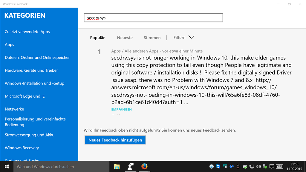

    I was not able to find any entries about secdrv.sys in Windows 10 feedback app. Created one now. please help to upvote and spread the word.
    For the legacy! (games) ;)
