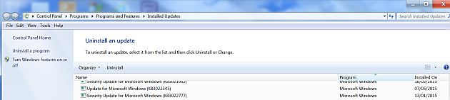

    This computer as evidenced by the image below.
    2015-05-19T15:12:36+00:00
    Gerry, the image is too faint to be readable to me.  Are you telling me that this particular Windows 7 computer has KB 3022345 installed and SFC does not report a problem?

    Well FWIW I saw this and thought I should run SFC and sure enough corruption found - 3022345 uninstalled and hidden - SFC re-run... corruption gone!
    Thanks for bringing this to everyone's attention. - Ric.
