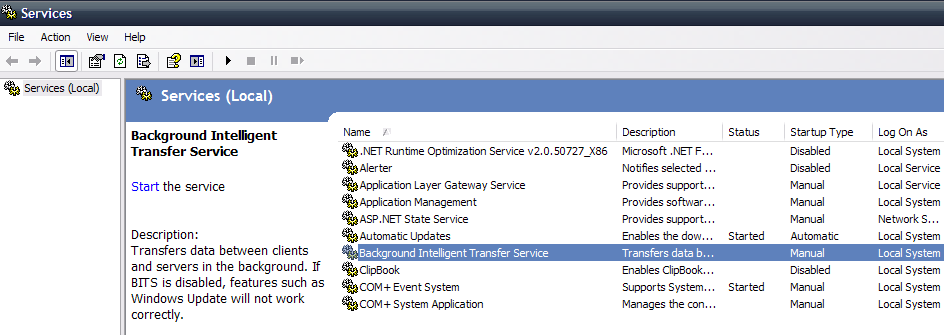

In the list of Services, can you see Background Intelligent Transfer Service ?
Here's a pix of what it looks like.

    Go to Start, Run, copy/paste this command and click OK: services.msc
