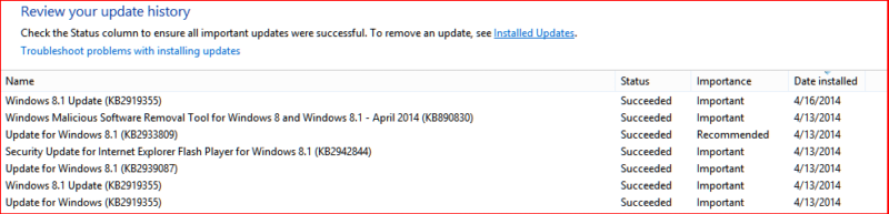

2014-04-17T17:17:17+00:00
Please note that's 64bit only
To make that work on 32bit do:
Also note AMD does not mean this only works on AMD chipsets.  AMD invented the 64bit platform, so even if you are running 64bit intel, that amd64 notation is still valid.
sfc /scannow
DISM /online /get-packages /format:table | findstr KB2919355
DISM /online /remove-dism /online /remove-package /packagename:Package_for_KB2919355~31bf3856ad364e35~x86~~6.3.1
DISM /Online /Cleanup-Image /ScanHealth
DISM /Online /Cleanup-Image /RestoreHealth
DISM /online /cleanup-image /startcomponentcleanup /resetbase
cleanmgr.exe
@echo off
Echo Cleanup complete
pause
