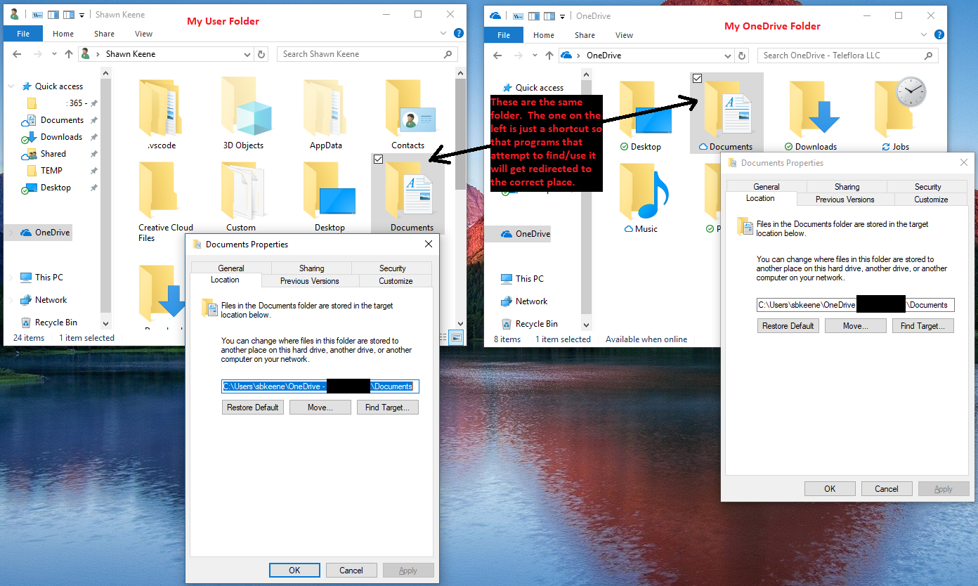

    It's really likely that the Documents folder in your user folder is actually just be a shortcut to the Documents folder in your OneDrive folder.  It's a special kind of shortcut called a symlink or junction point (not like a regular shortcut, so it won't show the "shortcut arrow icon" on it).
    Here's how to tell if this is the case:
    1)  Open your User folder (for me this would be c:\users\sbkeene)
    2)  Right-click the Documents folder and choose Properties
    3)  Check the Location tab of the properties dialog box. If it shows that the Documents folder is stored in OneDrive (like my Example below), then the icon is just a shortcut and not an extra copy of all your files.
    2018-08-15T16:12:55+00:00
    Thanks for the amazingly quick reply :)
    Unfortunately I can no longer do what you suggest because I already erased the Documents folder. In fact, I'm pretty sure it was an actual copy because after erasing the Documents folder in C:\users\frousselot I regained the disk space it occupied when "moving" (actually copying) the location of the Documents folder to OneDrive.
