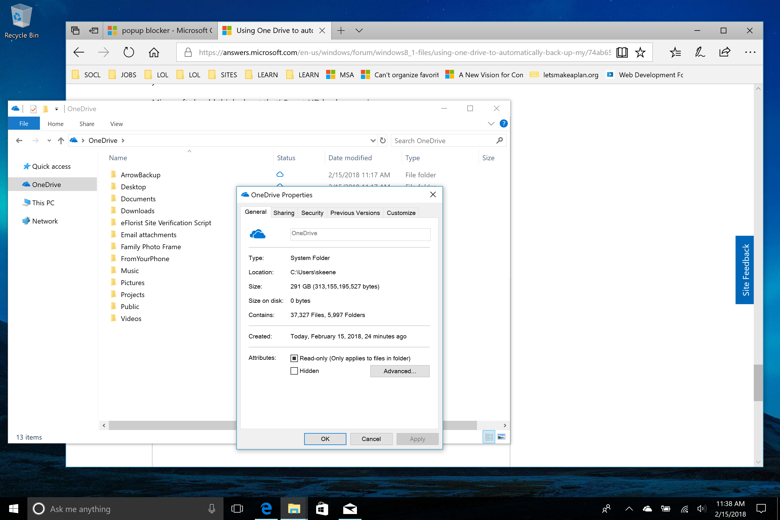

Perhaps the easiest way is to set the Documents folder to be saved inside your OneDrive folder.
  1. If you don't already have one there, create a folder named "Documents" inside your OneDrive folder.
  2. Right-click the original Documents folder (not the one created in step 1), and choose Properties
  3. On the Location tab, click Move, and choose the Documents folder you created in step 1.
  4. Confirm that you want to move your Documents folder.
You'll still see a Documents folder inside your C:\Users\Tony folder, but it's actually become a redirect -- anything put there will actually be inside OneDrive (both on your hard drive and, of course, synced up to OneDrive cloud).  You can even do this for your Desktop folder and other special shell folders that have a location tab on their properties.

    OneDrive just keeps continuous sync of files.  Any file you drop into your c:\users\dizz\onedrive folder on your own hard drive will also sync and be stored at onedrive.com, so you can get to that file from any browser on earth, even your phone if you wanted.
    Even if OneDrive servers got vaporized by aliens and all the cloud storage was gone, your local copy stored on your C: drive would still be there like always.  The files never leave your computer, and they are always "just regular old files", so there's never a risk, and you can use your existing backup strategy without changing it at all.
