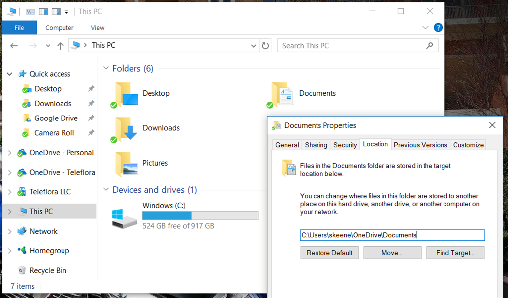

Perhaps the easiest way is to set the Documents folder to be saved inside your OneDrive folder.
  1. If you don't already have one there, create a folder named "Documents" inside your OneDrive folder.
  2. Right-click the original Documents folder (not the one created in step 1), and choose Properties
  3. On the Location tab, click Move, and choose the Documents folder you created in step 1.
  4. Confirm that you want to move your Documents folder.

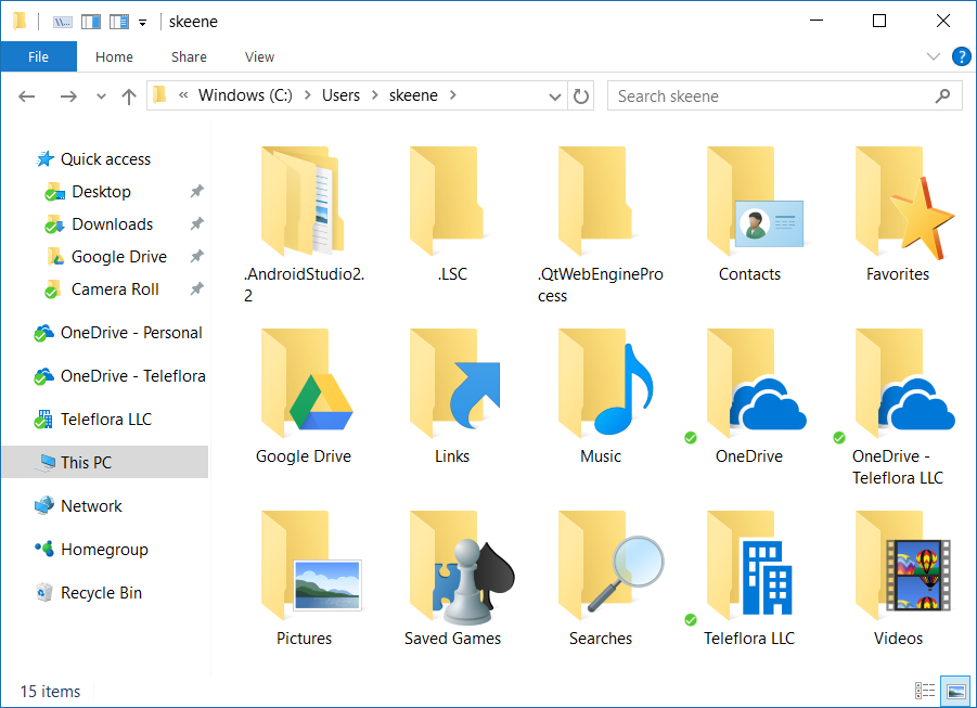

You'll still see a Documents folder inside your C:\Users\Tony folder, but it's actually become a redirect -- anything put there will actually be inside OneDrive (both on your hard drive and, of course, synced up to OneDrive cloud).  You can even do this for your Desktop folder and other special shell folders that have a location tab on their properties.

    I guess my original instructions were missing numbers. Breaking it apart might make it easier to follow.
    2.  Go to the C:\Users folder, and then into the folder with your username. Here you'll find your original Documents folder (not the one created in step 1). Right-click it and and choose Properties.
    3.  On the Location tab, click Move, and choose the Documents folder you created in step 1 (the one inside OneDrive, not the one inside your username folder).  Note that when you click OK you may get prompted to confirm. Just answer Yes/OK to the questions.
