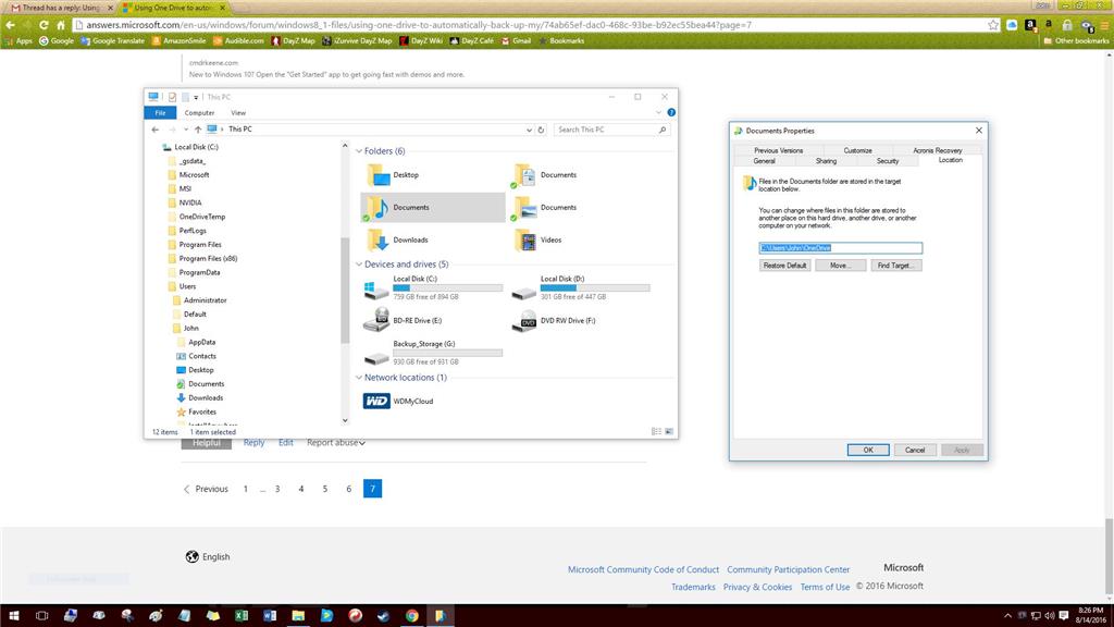

    Shawn,
    Well, I got my new PC up and running... took your advice and installed Win10 Pro on an SSD... sweet.
    Once I had everything running and looking the way I wanted I "mapped" my Documents, Pictures & Music folders to OneDrive... I'm thinking that I should have only mapped the Documents folder as I now have 3 separate folders with the same name "Documents" (appearing both under "Quick Access" & "This PC") in the File Explorer... see attached image.
    All three of these "folders" contain exactly the same thing as what appears under the OneDrive folder and all three have the same exact path in folder properties.
    Are these "ghosts"... can I delete them? Should I just start over (reinstall Win10) and only map the Documents folder to OneDrive... quite perplexing!! LOL!!
