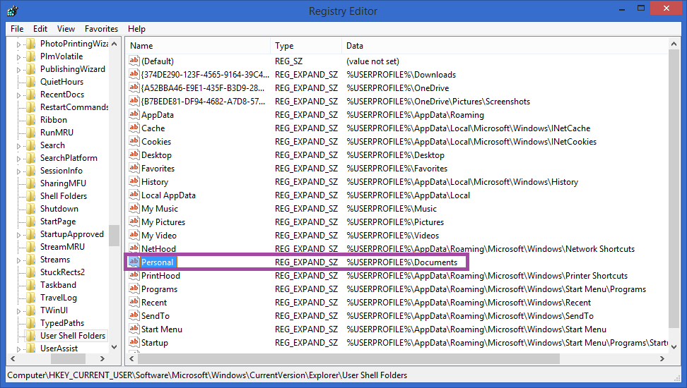

The "Restore Default Location" button won't be available, but you will certainly be able to put Documents back to the proper location if you decide to do so later.  That warning is actually a bit of a stretch.
It's possible (although incredibly unlikely), that you would have to go set the Documents folder path correct in the registry, but even that is actually pretty quick and easy if you needed to.
In the registry, this value controls which folder is considered the "documents" folder.  It's under HKEY_Current_User\Software\Microsoft\Windows\CurrentVersion\Explorer\User Shell Folders
