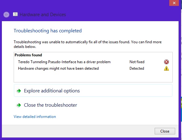

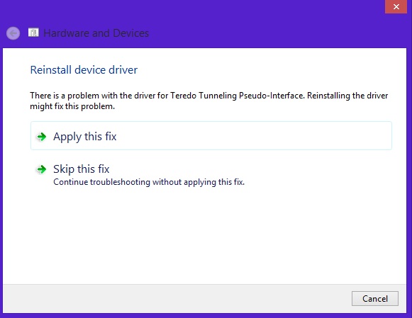

    Somehow I never got notified of this response till someone else responded.
    I've attached a couple screen shots of the results of running the Device Troubleshooter.
    2015-06-26T19:57:46+00:00
    Thank you for the information.
    It seems that there are some corrupted drivers existing in the device manager. I would suggest you to try the following steps to uninstall all the hidden drivers for webcamdevice and restart the computer. Let the Windows install the generic drivers and then see if it helps you to fix the issue.
