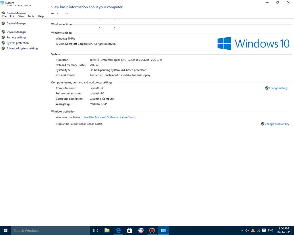

    Dear Jayant
    I have found that changing DNS serving settings to Google`s Server does not work on any OS be it Window 8.1 or Win 10.  If you have correctly filled in DNS server settings of your internet service  provider this particular update error does not occur.  All those who face Windows Update  error 8024402C may please check that their DNS server settings are the same which their ISPs have initially provided.
