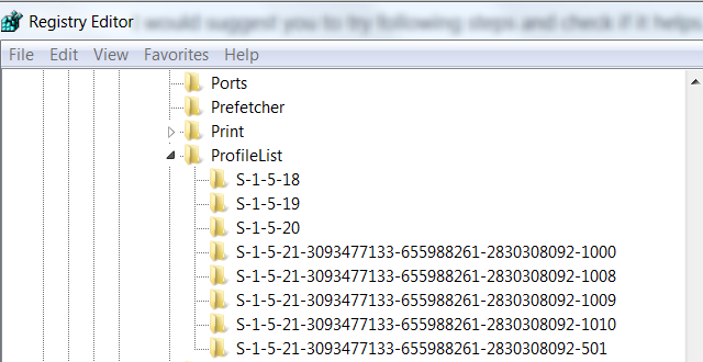

    I hope that you do not mind now the poster has said the thread should be closed. I am having a problem with errors in the CBS log and there is reference to 'duplicate files' and I was wondering if your suggestion about deleting duplicate files in the Profile List might cure the problem? (Or are there no duplicate profiles?)Thanks
