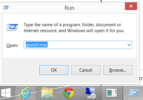

    2014-08-22T04:46:54+00:00
    The ANSWER:
    Step 1. Press <WindowsKey> + X to bring up the Run Command
    Step 2. Type "gpedit.msc" and click OK
    *The Local Group Policy Editor opens*

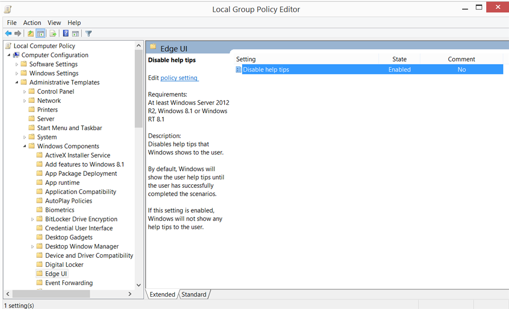

    Step 3. Expand "Computer Configuration / Administrative Templates / Windows Components / Edge UI" to find "DISABLE HELP TIPS"

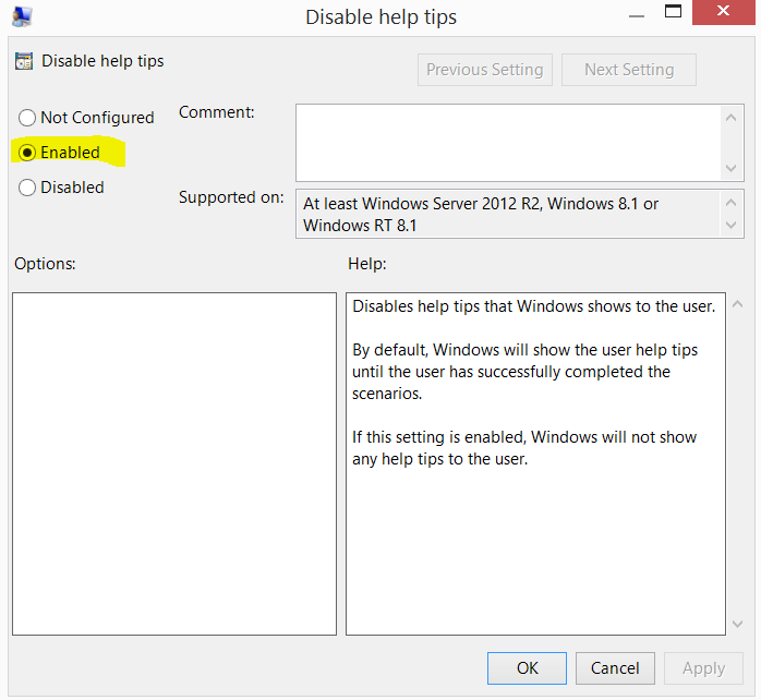

    Step 4. open this 'Setting', Enable it, CLICK OK and close Group Policy Management Console
    Step 5. Restart your computer And the tips are gone...
    Any NEW user that logs onto that computer, will also inherit those settings. It WILL not EVER both you again...
