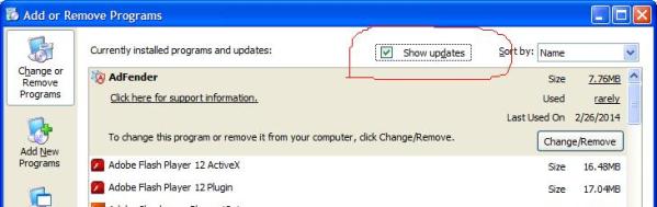

    control panel>add/remove> then check to show updates

    that was an automatic update, KB2934207
    look in the control panel, make sure Show Updates is clicked at the top of the box, look for this update and uninstall it.
